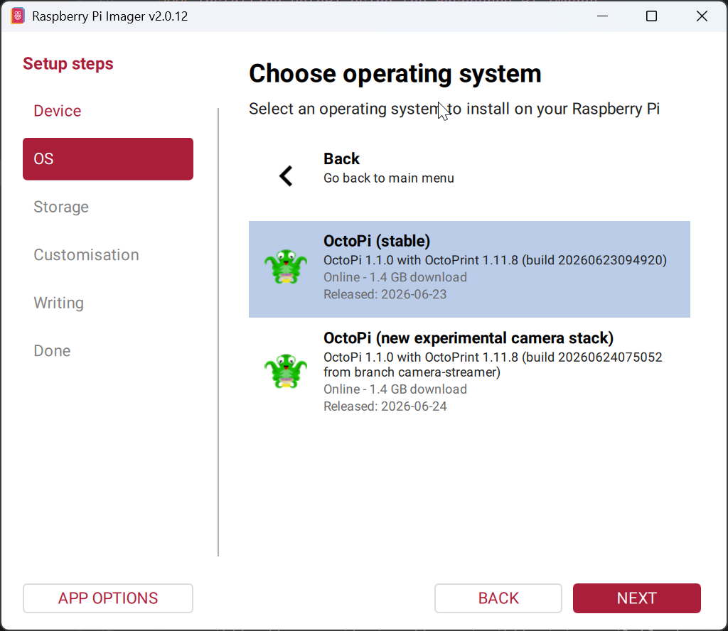

Locate the OctoPi Image
Find the OctoPi image under “Choose operating system” by selecting “Other specific-purpose OS” > “3D printing” > “OctoPi” and then the “stable” version.

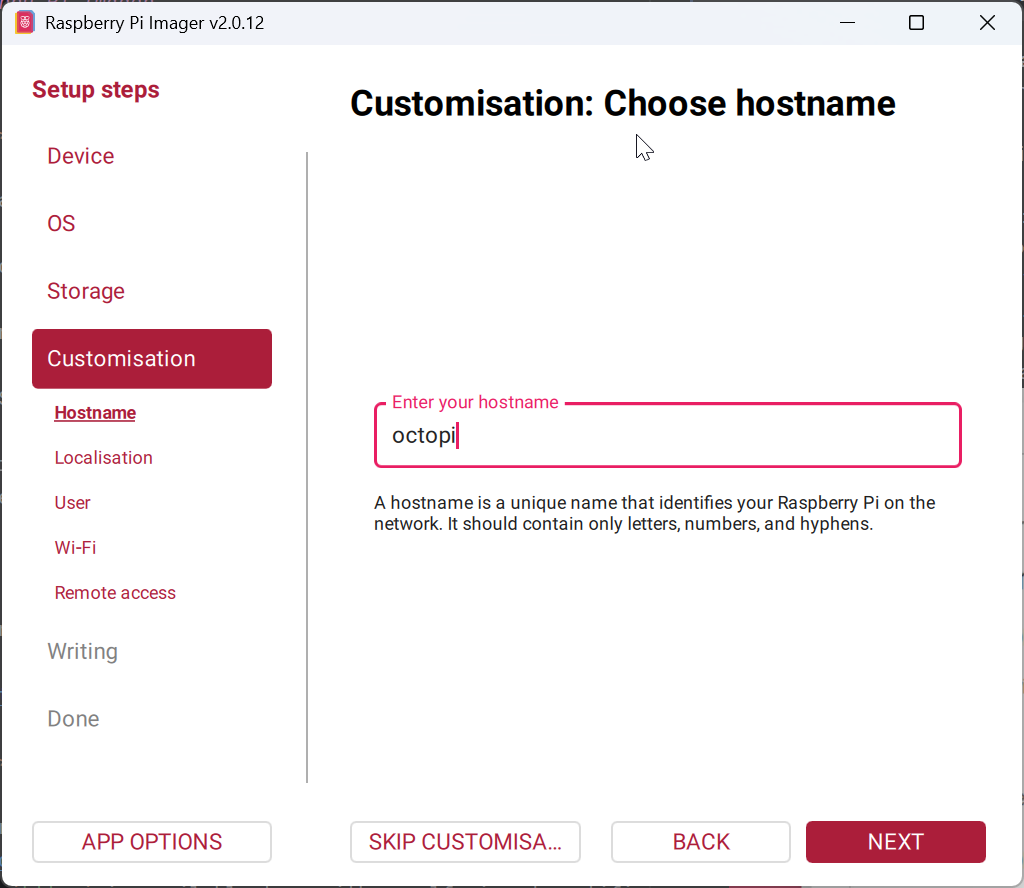

Enter the hostname of your choice. If unsure, set it to
octopi.

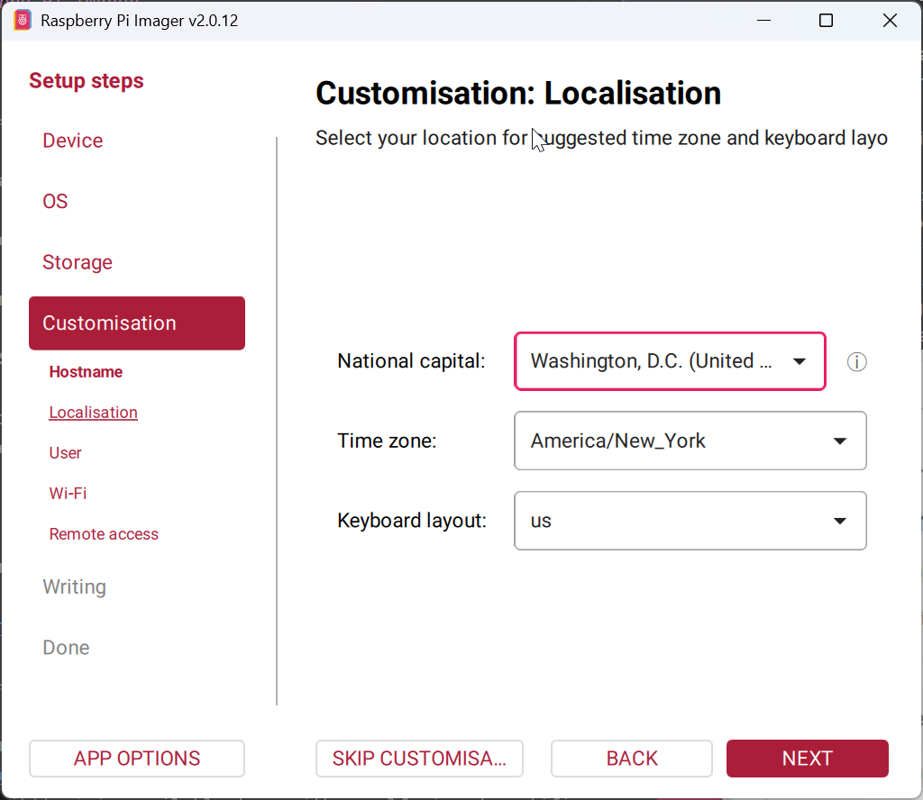

Configure your Localisation options. You should at least select the right time zone and country (via “National Capital”).

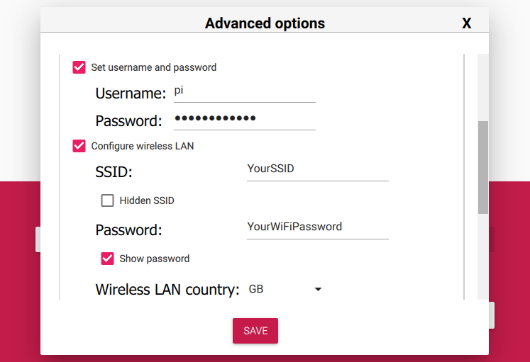

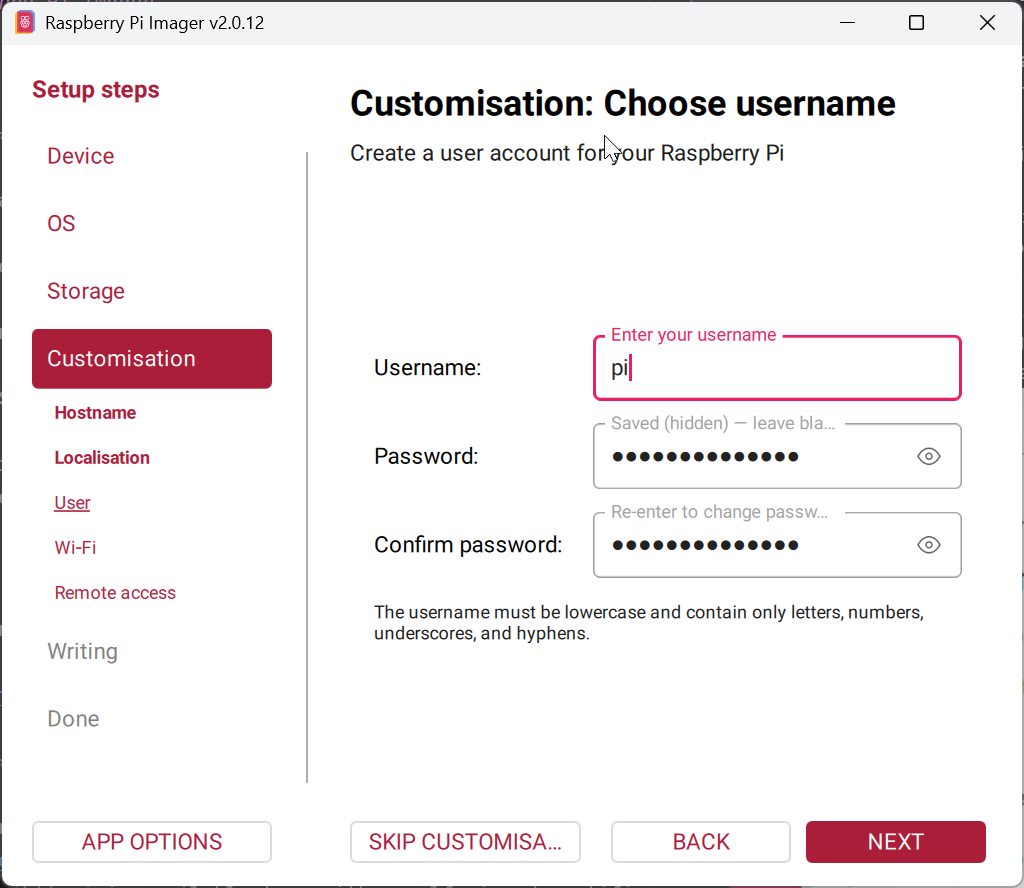

Enter User details for the system login. If unsure, leave the user as
pi, but be sure to set a new password. This is not the password you’ll use for logging into OctoPrint but one that you’ll have to use to log into your Pi via SSH should you ever need to. Make sure to note it down!

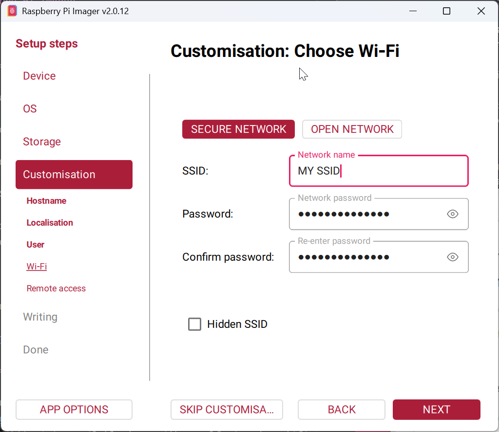

Enter Wi-Fi details. Set your SSID and password.

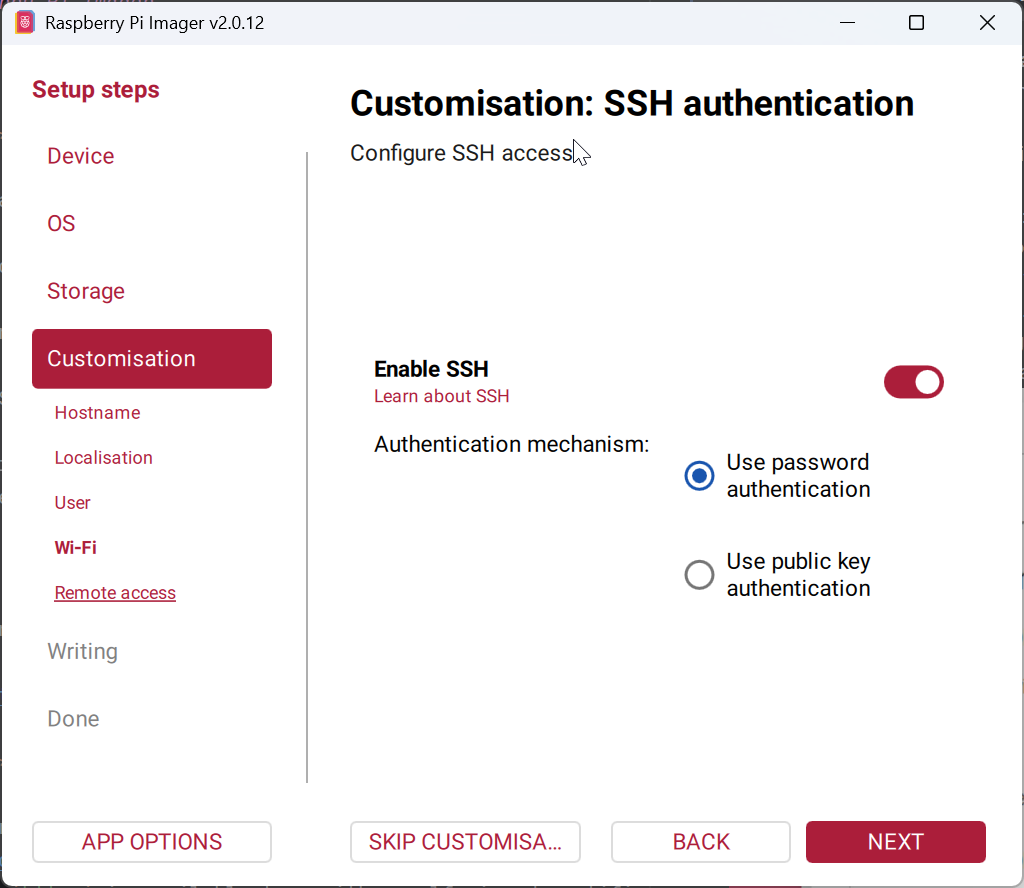

Enable SSH under Remote Access. This is useful for troubleshooting and installing system level requirements/dependencies as necessary.

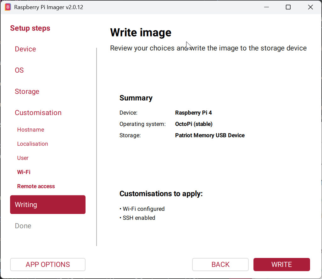

Flash your SD card
Install the image to your SD card, then plug everything in to your Raspberry Pi and boot it up. Do not format the SD card after installing, even if prompted to do so. This will break the installation and you will have to start over!
